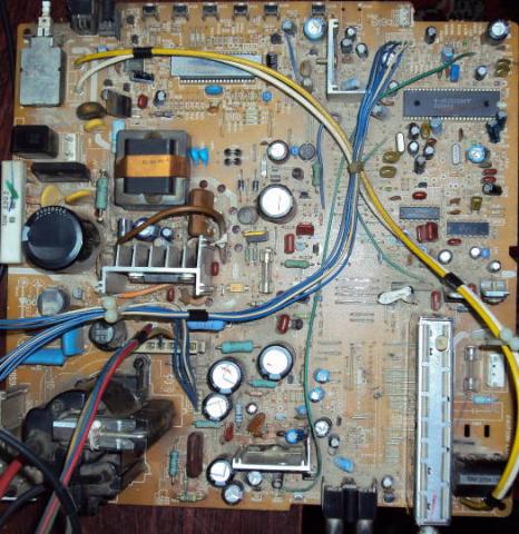

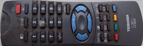

    عکس شاسی و ریموت کنترل تلویزیون TOSHIBA-HAY-1933 و مشخصات فنی
    تاپیک انواع معرفی انواع شاسی تلوزیون توشیبا TOSHIBA همراه با عکس ومشخصات فنی
    Processor: TOSHIBA-HAY-1933
    8897CSCNG7A15
    ZQ - 8MHz
    EEPROM - FM24C08A
    Tuner - ET-5EE-K06
    MUSIC - 2SC5296
    IC CD - LA78045, STV8172A, TDA8172
    VLF - AN17821A
    Switch AV / TV - HEF4053
    TDKS - BSC27-T1051A
    CRT SlimFit - A51ERU191X03 firm HUAFEI.
    UPS - STRW6556A + PC817

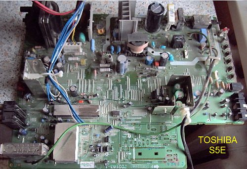

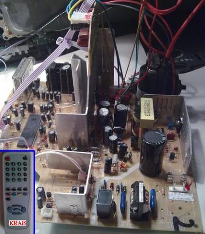

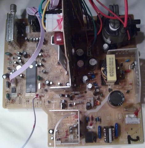

    TOSHIBA 14C2R Bomba
    S5E --------------------------------- series (scheme)
    20C3ERAPF
    8801CRCNG6DJ6 ------------- UOC
    CSI24C08L ---------------------- memory
    BD3886FS ----------------------- Audio percent.
    ENV59DA7G3 ------------------- tuner
    LA42052 -------------------------- ULF
    AN5522 --------------------------- footage
    STR W5753A ------------------- bp
    BSC23 - N0102 / TFB4122JG-tdks + 2SC5884
    A34LRQ90X --------------------- CRT
    UW-transistor
    Ud in 113. D.r in 74.

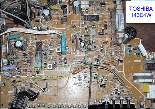

    TOSHIBA 143E4W
    TOSHIBA 143E4W
    TOSHIBA 143E4W
    Hot Chassis
    M50430-581SP --------------- pct
    M58658P ---------------------- memory
    TA7699AP --------------------- videoprots
    TA7680AP --------------------- upchI and Sound
    TDA3651A --------------------- footage
    TDA1015 ----------------------- ULF
    EG613F ------------------------ tuner
    TFB4036AD ------------------- tdks + 2SC3715
    STR50020 --------------------- bp
    A34EAS00H ------------------ CRT
    UW-transistor
    Pp 103 to. Other - none.
    In tv only local control.
