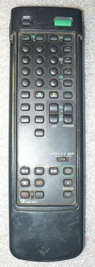

    ریموت کنترل

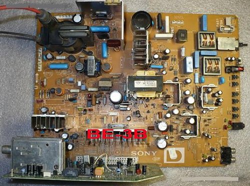

    مدلهایی که این شاسی روی آنها به کار گیری شده است
    KV-24WS1A, KV-24WS1D, KV-24WS1E, KV-24WS1K, KV-24WS1R, KV-25M1A, KV-25M1D, KV-25T1A, KV-25T1D, KV-25T1K, KV-25T1R, KV-25T1U,KV-28WS1A, KV-28WS1D, KV-28WS1E, KV-28WS1K, KV-28WS1R, KV-28WS1U, KV-B2531D, KV-B2931D, KV-C2171D, KV-C2171K, KV-C2171KR, KV-C2173E, KV-C2581A, KV-C2581D, KV-C2583E, KV-C2980B, KV-C2981A, KV-C2981D, KV-C2983E, KV-C2991A, KV-C2991D, KV-M2540B, KV-M2540D, KV-M2540E, KV-M2540K, KV-M2541A, KV-M2541D, KV-M2541E, KV-M2541K, KV-M2541L, KV-M2541U, KV-C2171KR, KV-X2002U, KV-X2100B, KV-X2101A, KV-X2101D, KV-X2101K, KV-X2103E, KV-X2181D, KV-X2182U, KV-X2183E, KV-X2501A, KV-X2501D, KV-X2501K, KV-X2503E, KV-X2581A, KV-X2581D, KV-X2581K, KV-X2581KR, KV-X2582U, KV-X2583E, KV-X2900B, KV-X2901, KV-X2901A, KV-X2901B, KV-X2901D, KV-X2901K, KV-X2902, KV-X2902L, KV-X2903E, KV-X2981K, KV-X2981KR, KV-X2982U, KV-X2983B, KV-X2983E
    مشخصات قطعات شاسی
    Main - 1-711-855-12
    Micom - CXP85340A-188Q
    Memory - ST24C32 6
    SMPS - STR-S6708
    SAW - K9350M & K3953M
    Video - TDA8366H
    VIF - TDA9813T TDA6622-2X
    Vertical - STV9379
    Sound - TDA7261
    Tuner - BTP-EC411 8-598-045-01
    Tube - M60LCS60X
    FBT - 8-598-988-00
    HOT - 2SC4927
    RGB Amp - BF871
    Remote - RM-837
