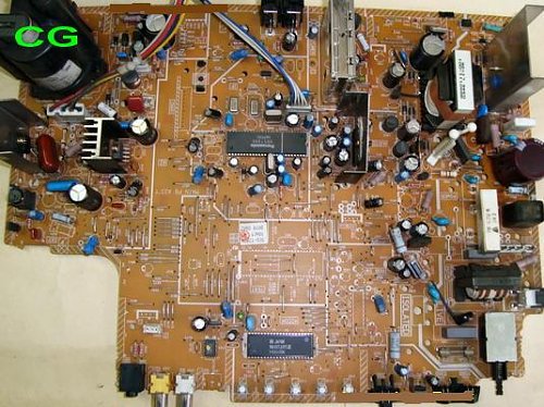

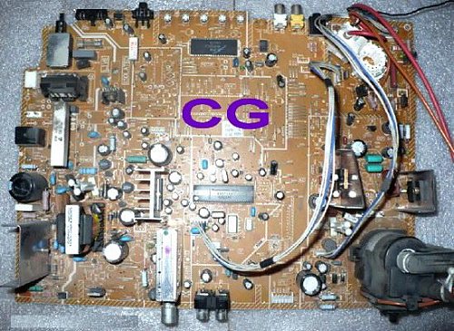

    مدل هایی که این شاسی در آنها به کار رفته است
    AV-21FT (SCG-1266A) / JVC AV-1407AE, AV-1413EE, AV-14A10, AV-14A3-1, AV-14F10, AV-14F3, AV-14F4EE, AV-20N4, AV-2103YE, AV-2104TEE, AV-2105EE, AV-2115EE, AV-2116EE-SK, AV-2136EE, AV-21A10-3, AV-21A30-1, AV-21A4EE, AV-21E3, AV-21F3, AV-21F4EE, AV-21FMG3B, AV-21FR3, AV-21FT, AV-21LMG3, AV-21LMG3/A, AV-21LMT3, AV-21LT3, AV-21LT3/AU, AV-21LTR1, AV-21LTR3, AV-21LTT1, AV-A14M3, AV-A14M3-A, AV-A14T3, AV-A14T3(HK), AV-A14T3-A, AV-A14U3
    مشخصات شاسی و قطعات به کار رفته درآن
    Main - CKF1349-DH2-1
    Micom - MN1873287JA1
    Memory - 24C08
    SMPS - STR-G6653
    SAW - F1816JS & B5388
    Video - NN5198K
    Vertical - AN5539
    Sound - LA4287
    Tuner - QAU0185-001 TUVIF4EG-771F2
    Tube - A51LMV20X
    FBT - QQH0134-001
    HOT - BU808DFI
    RGB Amp - 2SC3271F
    REMOT : RM-C364 RM-C90
    Main - CKF1542-CH1-1
    Micom - MN1873287JE
    Memory - BR24C08
    SMPS - STR-G6651 & SE115
    TR Chopper - QQS0111-001
    SAW - F5418 & B5388
    Video - NN5198K
    Vertical - AN5522
    Sound - AN5265
    Tuner - QAU0192-00Z TAEL-G503D
    Tube - A51KQK99X + DCT-2192ML
    FBT - BSC25-0262A QQH0102-001
    HOT - 2SD2627
    RGB Amp - STC344
    REMOт: - RM-C333
