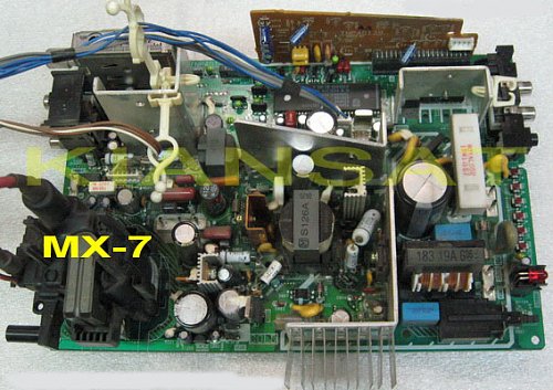

    مانوئل سرویس Panasonic TC-21PM10R CHASSIS: MX-7 همراه با عکس
    همراه با عکس
    مشخصات:
    Main - TNP4G1361AT
    UOC - TDA9363PS/N1/3L0230 (TDA9463L064A)
    EEPROM - 24LC16B
    SMPS - STR-F6656
    SAW - K7256M
    Tuner - ENV59D82G3
    VA - LA7840
    Sound - AN7523
    Stereo/dual SP - TDA9820T
    E/W - TEA2031
    Tube - A51LSK955X 07 + KDY3NWB63F
    RGB Amp. - TDA6107Q
    FBT - ZTFN32001A
    HOT - 2SD2553 (BU2708DF, BUH517D, 2SC4963)
