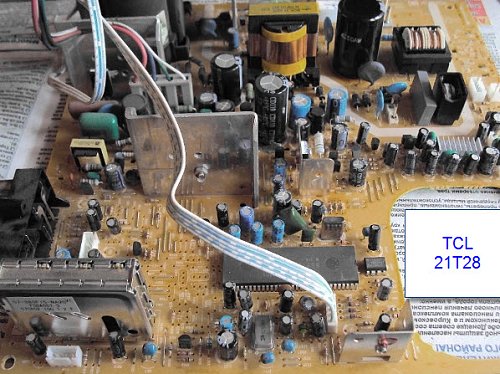

موضوع: عکس از شاسی TCL 21T28 same TCL14D1ومشخصات فنی مداری
    TCL 21T28 same TCL14D1 and Liberton Lic 14000NF
    13-T18M28-01M01
    8691CSBNG6N54 ----------------- UOC
    Atmel712 24C08A ---------------- memory (flash)
    TDA4864AJ ------------------------ footage
    07-380F15-NA2G FSDA05T-3 - Tuner
    BSC 25-0252T -------------------- tdks + BU4508BDZ (TO220F)
    2SC5586 --------------------------- Key "Chinese" bp
    A51CPAA00X04 (E) -------------- CRT
    Pp 110 to. Dr 112 in.

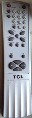

    منو سرویس:
    Log-in service:
    1. remove the volume to "0"
    2.
    Simultaneously press the keys on the local "VOL-" and DISP (a rectangle with a "+") on the remote.
    Listen
    Read phonetically
