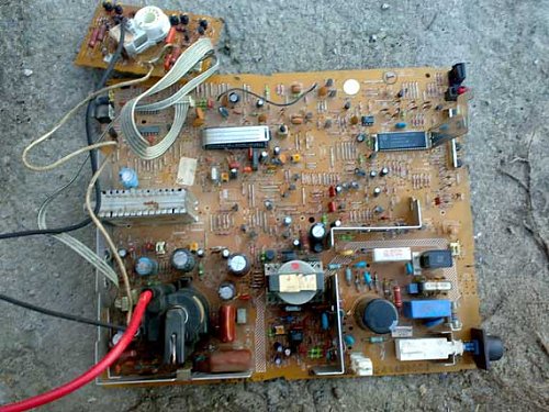

موضوع: عکس و مشخصات فنی تلوزیون فیلیپس Philips Model: 21PT133A/58R Chassis: ANUBIS-S
    Chassis: ANUBIS-S
    Ingredients:
    BP - STP6N60F1 (UC3842BM) is (TDA4605-3);
    Video - TDA8362;
    Acad. Ex. - PCF84C844;
    CD - TDA3653A.
    سرویس مد یا منو مخفی
    Log in to the service mode by contact closure, M31 and M32 (land) near IC7710.
    Exit STAN-BY
    Click here to enlarge.
