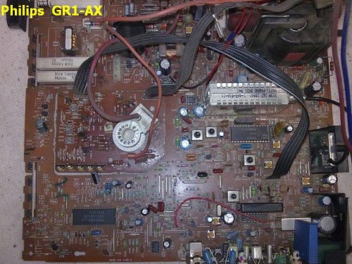

    شاسی تلوزیون PHILIPS GR1-AX Chassis همراه با مشخصات فنی
    TMP47C434N-3414 ---------------- m / Controller
    TDA8305 ------------------------------- p / channel + synchro
    TDA7052 ------------------------------- ULF
    TDA3565 ------------------------------- in / processor, PAL
    TDA3592A ----------------------------- SEKAM
    TDA3653B ----------------------------- footage
    UV711 ---------------------------------- tuner
    2436201 -------------------------------- TDKS, CRT 54 cm

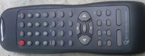

    RC-5 with a direct choice of adjustments ----- RC
    BP discrete. Regimes + B: PP = 95 volts, DR = 4.7 volts
    TV can be no control, although a place in the p / receiver est.Dlya adaptation - set the F / receiver and replace the resistor 2720 (100 ohms) to the capacitor 1000 pF
    Tuning in channels - front paneli.Nazhimaem STORE (first left) then click (+) when you stop searching - set to the desired program and press STORE
