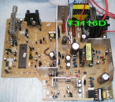

    مشخصات فنی قطعات شاسی
    شارپ
    Main - 7800-T3116D-02
    Micom - TOSHIBA-HAY-26 8891CSCNG6V12
    Memory - FM24C08A
    SMPS - 2SC5287 / 2SC5302
    TR Chopper - BCK-01-EC39 / BCK-4901A (BCK-150-01)
    SAW -
    Vertical - LA78040B / LA78041
    Sound - UTC2003
    Tuner - CXEL-VS1-1G5-BG / ET-5EE-K04 / ET-5EE-V61 / DWC-8053V
    Tube -
    FBT - BSC25-T1010A / BSC25-Z1003AH / BSC27-0213A
    HOT - MD1803DFX /
    2SD1651C
    TMPA8891CSCNG6V12

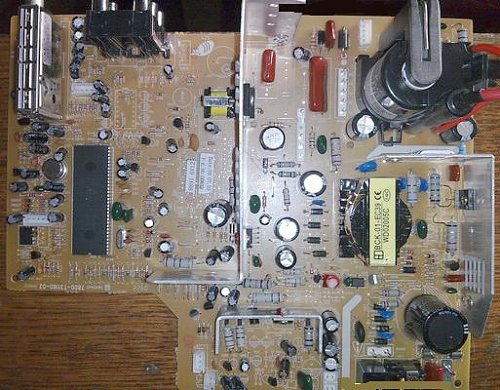

    الجی
    Main - SC-2167
    Size - 198x247mm
    Micom - TOSHIBA-HAY-23 8873CSCNG6V09
    Memory -
    SMPS -
    TR Chopper - BCK40-19
    SAW -
    Vertical - LA78040B
    Sound - TDA2003
    Tuner - VS1-165 BG
    HOT - MD2103DFX
    RGB Amp -

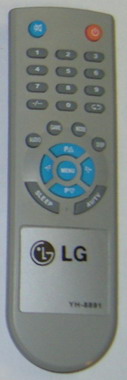

    REMOT: - YH-8891
    TMPA8891CSCNG6V12
