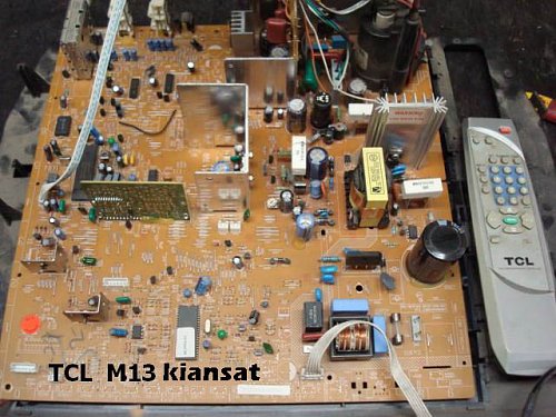

    شاسی تلوزیون TCL M13 chassis
    TCL M13 chassis
    TMP87PS38N
    (M13VR3-V2) ----------------------------- m / Controller
    TB1240AN --------------------------------- in / Processor
    TDA2616 ----------------------------------- ULF
    TA1216AN --------------------------------- audio processor
    TA8427K ----------------------------------- footage
    44608P40 + 2SK2996 ---------------- BP
    BSC290-1650X -------------------------- TDKS
    A68ESF004X ---------------------------- kinescope
    Mode BP DR = 16 volts, RR = 140 volts
    Log-in service:
    1 - The front panel button to set the volume to Vol-zero
    2 - without releasing the button press on the remote display
    3 - transition to "windows" menu via the remote control number buttons ... output - power off
