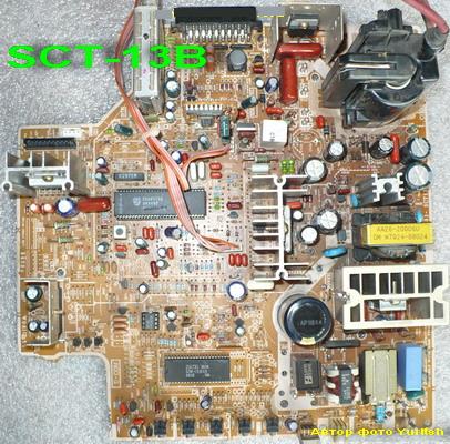

    مدل هایی که این شاسی روی آنها به کار گیری شده است
    CK-3385ZR / Samsung CK-331EZR, CK-331FZR, CK-3338ZR, CK-3339ZR, CK-333EZR, CK-3366ZR, CK-3373TR, CK-3373ZR, CK-3385TR, CK-338CTR, CK-338CZR, CK-501ETB, CK-501EZR, CK-5038ZR, CK-5039T, CK-5039TR, CK-5039ZR, CK-503ETR, CK-503EZR, CK-5066TR, CK-5066ZR, CK-5085TB, CK-5085ZR, CK-508CR, CK-508CTR, CK-5338ZR, CK-5339TR, CK-5339ZR, CK-5366T, CK-5366TB, CK-5366TR, CK-5366ZR, CK-5385T, CK-5385TB, CK-5385ZR, CS-3385Z, CS-5366
    مشخصات فنی قطعات به کار رفته در این شاسی
    Main - AA41-10867A
    Micom - SZM-193EER
    Memory - KS24C041
    SMPS - 3S0680RF
    TR Chopper - AA26-20006U
    SAW - K2971M
    Secam - TDA8395P
    Delay - TDA4665
    Video - TDA8374A
    Vertical - TDA8356
    Sound - TDA7056AQ
    Tuner - AA40-10006H TELE4-108A
    Tube - A34KQV42X
    FBT - FSV-14A001 (HR8207)
    HOT - 2SD5071
    RGB Amp - TDA6107Q
    REMOT: - AA59-10081F
    IC remote - KS51810-79
