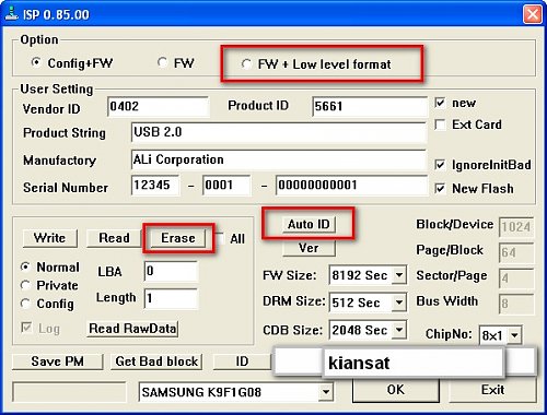

    Before  that point the wayIn fact this tool to upgrade the program's tool kit  which contains a, but may not provide individual solutions provider.   For various reasons, Ali FAE programs seem not enough support for  manufacturers, which is why the ALI program is relatively cheap, sound  quality is also on the level, but with less reason manufacturers.   I uploaded this software is for this reason, just because I found that  many engineers are doing this program will not use this tool, and its  operation is so simple, when you repair a ALI5661 the MP3, if you can  recognize, but can not upgrade, then this tool can help you a favor:
    Figure after the  midpoint of Auto ID, such as automatically appear in the next you can  only use the FLASH model, then congratulations, you basically had no  problem welding FLASH, check box before you can select ALL, the point  about ERASE erase FLASH, and then Try upgrading.   If there are no models, you have to look tin FLASH drag friends to see  if there are no cold solder joint, there is no break, there is no master  data line Weld, or replace a FLASH try.   Commissioning the machine from my point of view, where there is a  correct model can not upgrade FLASH, then there may be two issues,  namely, the firmware does not, the second is wafer FLASH 0 select few  European resistance welding wrong, go see BOM friends.  .  .  .
