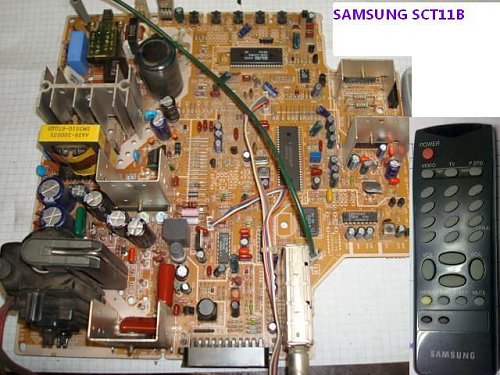

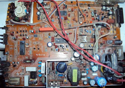

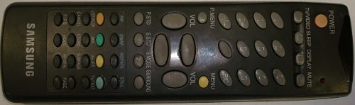

    عکس شاسی و ریموت کنترل تلویزیون SAMSUNG chassis SCT11B) و مشخصات فنی
    SZM-137M3 ---------------------- prots.upravleniya
    M52309SP ----------------------- Video Processor
    TA8445K -------------------------- footage
    TDA7056 -------------------------- ULF
    TECC2985VD28A ------------- tuner
    FSV-20A001 -------------------- TDKS
    HIS 0169B ... SMR40200 ---- PD
    TDA6103-------------------------в/усилитель
    PD DR ... - 135 volts ud - 125. runs on the load-60W
    10129C (one option) - Remote control
    Log in to the service ----- Stby ... Pstd ... Help ... Sleep ... Power on
    Listen
    Read phonetically

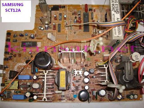

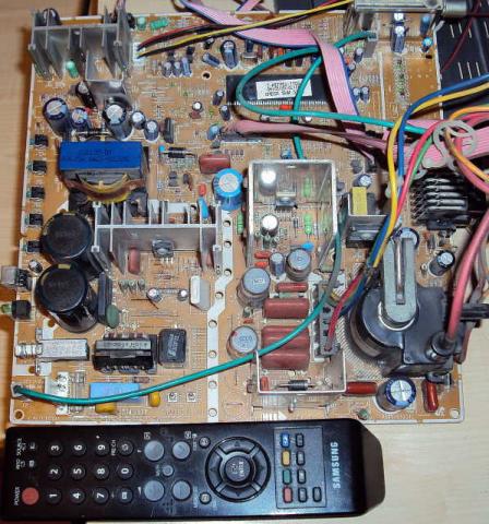

    عکس شاسی و ریموت کنترل تلویزیون SAMSUNG SCT12A و مشخصات فنی
    SAMSUNG SCT12A
    SZM-159RTX --------------- percent control
    TDA8374A ------------------ Video Processor
    TDA8356 -------------------- footage
    TDA7297 -------------------- ULF
    STRS6707 ------------------ BP
    TDA6101 x 3 --------------v/usiliteli
    FSV-20B001 --------------- TDKS
    10129C --------------------- RC

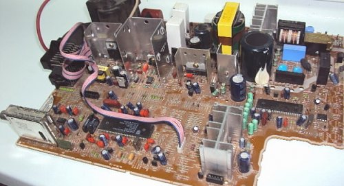

    SAMSUNG chassis: KS9A
    Processor: TDA9381PS/N2/3I1310 (SPM-802EEN5)
    Memory: A81DC (24C08)
    Stab: K7632
    Tuner: TECC0949PL35A (S)
    TDKS: AA26-00201A
    NOTES: D1878
    BY: TDA6107J
    Personnel: LA78048
    ULF: TDA8943SF
    PSU: 5Q0765RT

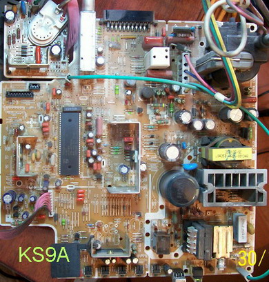

    SAMSUNG KS1A
    SAMSUNG KS1A
    TDA9381PS/N2/3I1310 ---- UOC
    TDA8943SF -------------------- ULF
    LA7840 -------------------------- footage
    TDA6107JF --------------------v/usilitel
    5Q0765RT ---------------------- BP
    14123001A --------------------- TDKS
    00104N -------------------------- RC

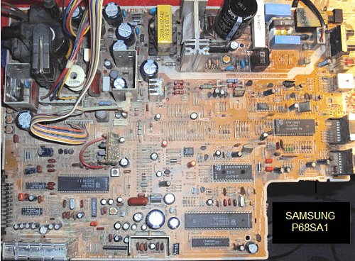

    عکس شاسی تلوزیون سامسونگ SAMSUNG CK-5342ATB bio و مشخصات فنی
    P68SA1 ----------------------------- chassis (circuit)
    SPM-109BT ----------------------- pct + 10.000 MHz
    KOR F 24C02 -------------------- memory (flash)
    SAA5254AP / H ------------------- mxm percent + 27.0mGts
    C81/CTV972 ---------------------- mxm ic + 9.8304 MHz
    KM6264BLS-7 ------------------- mxm memory
    TEA2014A ------------------------- mxm Switch
    TDA8362B ------------------------- videoprots
    TECC2989VA15B --------------- tuner
    KA2131 ----------------------------- footage
    TDA1013A --------------------------- ULF
    SDH-209B + 2SC5030F ------ bp
    FCM-20A015 + 2SD5072 ---- Wed
    A51KQJ63X ----------------------- CRT
    Pp +127 at. Dr 137 in.
    Service mode no.

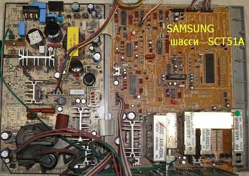

    شاسی تلوزیون SAMSUNG SCT51A chassis
    CXP85340A (SSOM-142EC) -------- m / Controller
    24C08P -------------------------------------- m / memory circuit
    TDA9160A ---------------------------------- PAL, Secam Decoder
    TDA4780 ------------------------------------ in / Processor
    TA8216H ------------------------------------ VLF,2-channel
    AN5342K ----------------------------------- color correction
    TDA9170 ------------------------------------ color correction
    TDA8350Q --------------------------------- footage + EW
    STRS6709 ---------------------------------- BP
    TDA6101Q x 3 ---------------------------- in / Amplifiers
    FTR-25A002 ------------------------------- TDKS, 25-inch CRT
    Mode BP the chain + In: DR = 40 volts, RR = 130 volts.
