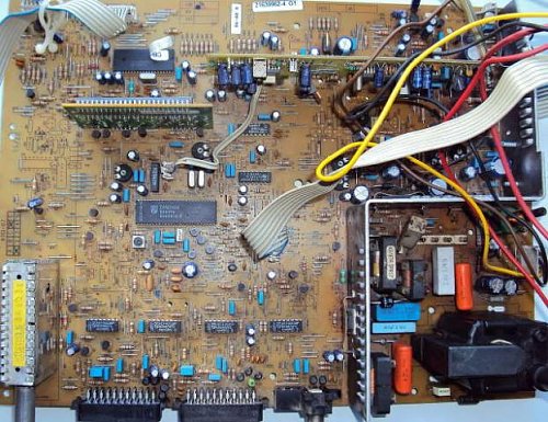

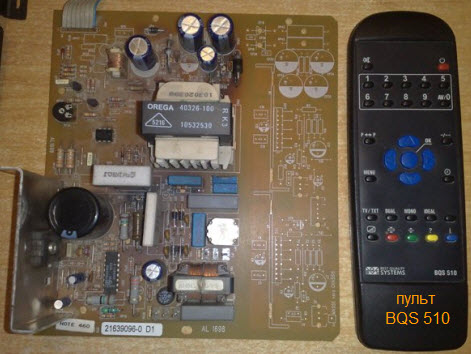

    عکس شاسی و ریموت کنترل تلویزیون KENDO CT98S71VT و مشخصات فنی
    KENDO CT98S71VT, he also ELBE 28S542
    K110-07 ---------------------------------------- chassis (circuit)
    ST6387B1 / FHL (EEPROM inside) ---- percent.
    HTP220S -------------------------------------- Tuner
    TDA8362A + TDA4665 + TDA8395P - Videos
    SAA5281P / E --------------------------------- Teletext
    MSP3400c-PP-c6 --------------------------- zv.prots
    TDA9811 -------------------------------------- VIF-PLL & AM demodulator
    TDA8196 -------------------------------------- Reg. volume of Scartho - 2 pcs.
    HEF4053BP ---------------------------------- switch - 4 pcs.
    TDA2616Q ------------------------------------ ULF
    TEA5101B ------------------------------------ wu
    TDA8380A + BU508AF ------------------ UPS
    OREGA 40326-100 ------------------------ TPI
    OREGA 40330-38 -------------------------- tdks + BU508AF
    TDA3654 -------------------------------------- footage
    A66EAK 71X01 Philips ------------------- complete loss of emission
