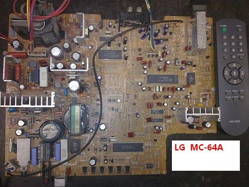

    عکس شاسی و ریموت کنترل تلویزیون LG chassis MC-64A و مشخصات فنی
    LG chassis MC-64A
    LG8534-07C ------------------ processor Exercise
    TDA8362B -------------------- Video / pct
    TDA2006 ---------------------- ULF
    LA7830 ------------------------- footage
    STRS5707 -------------------- BP
    154-375F ---------------------- TDKS
    105-230M --------------------- RC
    PSU ..... RR = DR = 115 volts, running a load-60W - without problem.Samye common "tipovuhi" C824 in power supply, C408 and D408 in CP

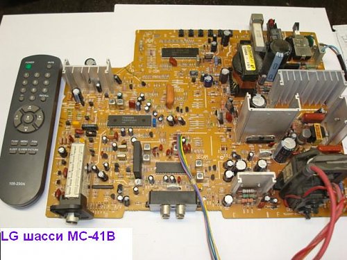

    عکس شاسی و ریموت کنترل تلویزیون LG chassis MC-41B و مشخصات فنی
    LG chassis MC-41B
    LG8534-13A --------------- percent Manage
    TA8690AN-----------------video/PAL
    TA8750 --------------------- SEKAM
    TA8445K ------------------- footage
    STRS6707 ----------------- PSU
    TDA2006 ------------------- ULF
    154-375F ------------------ TDKS
    103-230A ------------------ RC
    BP ... DR - 60 volts, ud - 115 volts

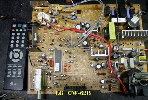

    عکس شاسی و ریموت کنترل تلویزیون LG chassis CW62B و مشخصات فنی
    LG chassis CW62B
    TDA12020PQ/N1/F00 ----------- Control Processor
    AT24C16A --------------------------- mikrsh. Memory
    TDA7297A --------------------------- ULF
    TDA4863AJ ------------------------- footage
    6174V-5003X ----------------------- TDKS
    6700MF0018A (TAEA-6011D)-Tuner
    STRW6754 -------------------------- BP
    TDA6107AJF------------------------В/усилители
    A51QGT420X ----------------------- kinescope, slim

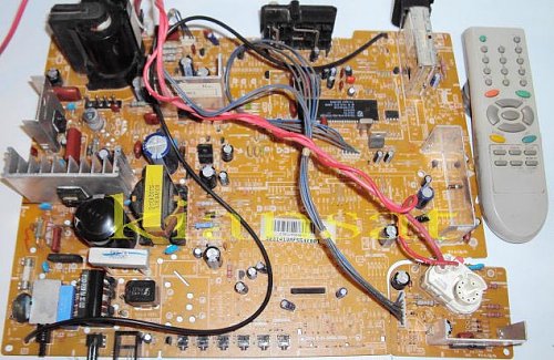

    پیش فرض LG CF-20F30K
    LG CF-20F30K
    MC-019A ------------------------------- chassis (circuit)
    TDA9381PS/N2/3I0792 ----------- UOC
    0ICTMPH010A
    ATMEL 24C16A ---------------------- memory (flash)
    LA7016 ---------------------------------- Switch
    LA7840 ---------------------------------- footage
    TDA2006 -------------------------------- ULF
    STR F 6654 ---------------------------- UPS
    6174V-6002K + TT2140 ----------- vksr
    DT5-BF70D ---------------------------- tuner
    TDA6107JF ---------------------------- wu
    6710V00090D ------------------------- console
    A48JLL90X07 ------------------------- CRT

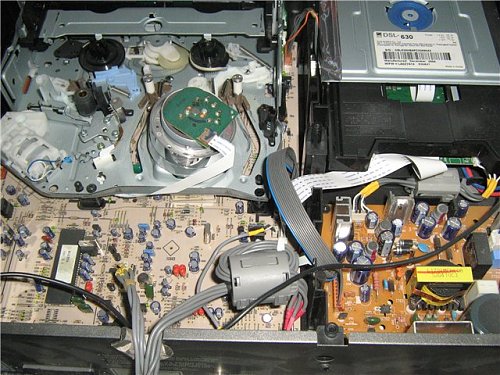

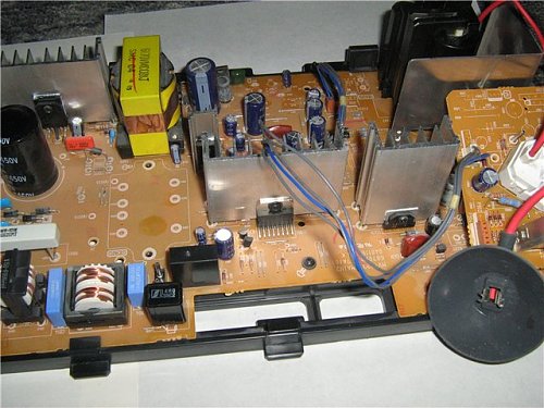

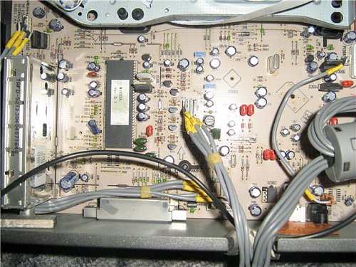

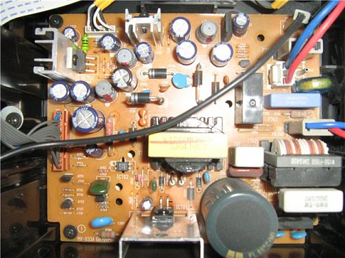

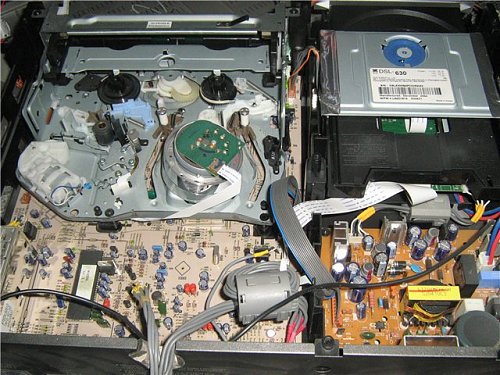

    LG Multiplex 55 on the label
    LG KZ 21FC70RX-in at the label.
    Videotroyka DVD + VSH + TV
    Chassis MV-033A MAIN 2
    Two power supplies. One internal DVD and VSH
    STR 6635 EM 43AD
    Television ---------- STR F 6654
    Manpower ----------------- LA 7840
    Tuner ------------------------ TAFD-S212D404D0802
    Cinhrovideoprots ------- MICRONAS
    VCT 3834F 06
    4502.2P LN F
    146244.001
    on the procedure label MV 033A ver 3.1
    Sound --------------------------- TDA 7287
    TDKS -------------------------- 6174V6006J analog HR 80177 or 6174V6006M
    6174V5003A not suit it at 110 degrees.
    Video amplifier ----------- TDA6107JF
    Control processor is covered with full of filth and place of the inscription is not possible to wash to read.
    The device immediately arises in the DR no matter how it turned off.
