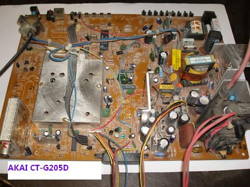

    AKAI CT-G205D aka GRUNDIG GR1450
    CTV222S ---------------------- processor Manage
    TDA8362 ---------------------- Video Processor
    TDA3653 ---------------------- footage
    TDA1013B --------------------- ULF
    FCM-20B027 ----------------- TDKS
    BS .... DR = RR = 115 volts
    Remote - RC-5 (BP-6)

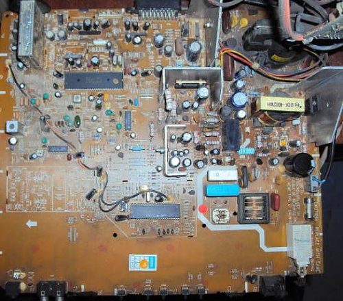

    عکس شاسی و ریموت کنترل تلویزیون AKAI 2107 aka ICE model 1151 و مشخصات فنی
    C68230Y -------------------------- management processor
    93LC46 ----------------------------m/shema memory
    AN5601K -------------------------v/prots, PAL decoder
    AN5633K ------------------------- SEKAM-PAL Converter
    TDA1904 ------------------------- ULF
    TA8701 ---------------------------R/kanal, synchro
    CFO341 -------------------------- TDKS

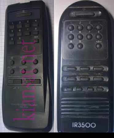

    RC-51A or IR3500 --------- RC
    BP diskretnyy.Upravlenie + B through rele.R.R. = 115V, DR = 125

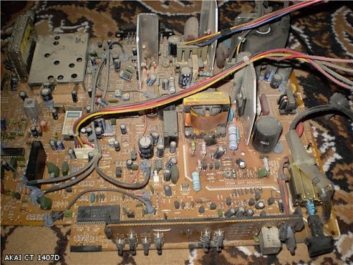

    عکس شاسی و ریموت کنترل تلویزیون AKAI CT 1407D و مشخصات فنی
    AKAI CT 1407D
    PSU transistor
    Processor ONWA KWTC C68230Y
    TDKS FCK 14A028
    Tuner VTS67H7
    Manpower TA 8403K

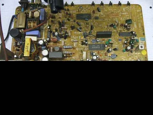

    عکس شاسی تلوزیون اکایی AKAI CT-21WKDومشخصات فنی
    AKAI CT-21WKD
    B20 ----------------------------------- chassis (circuit)
    MN152810 (kwmcc) ------------- percent.
    24S04 ------------------------------- memory (flash)
    AN5195K-C ------------------------ in / pct.
    AN5071 ----------------------------- com. , Range. and ctabilizator +31 v
    AN5637 ----------------------------- SECAM
    AN5534 ----------------------------- footage
    AN5265 ----------------------------- ULF
    MN3868 ---------------------------- delay
    FCM-21A004 +2 SD2499 ----- vksr
    TECC2989VA24B -------------- tuner
    2SD2498 --------------------------- Key "Chinese" bp
    A51KPO12XX -------------------- CRT
    Pp 110 V. Dr. 0V (relay).
    ورود به منو مخفی (منوسرویس)
    Log-in service: hold down the button on lokalke V + V-tv and turn on the power button
