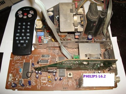

موضوع: عکس شاسی و ریموت کنترل تلویزیون PHILIPS L6.2 chassis (mono) و مشخصات فنی
    11,122
    68,446
    58,193 سپاس از9,059 پست
    TMP47C1637N-RA19 --------------- or
    SAA5290ZP/040----------------------prots Management
    TDA8362 -------------------------------- Video Processor
    TDA7056A ------------------------------ ULF
    UV915/1EC/3139--------------------Tyuner
    1392.5001 (54 cm kineskom) --- TDKS
    Vertical-transistor
    BP - Discrete D.R = ud = 95v - to / from 37-54 cm and 150 volts to / from 59-66cm 110gradusov
    RC8205 -------------------------------- RC
    The entrance to the service - to close the points S1 and S2
