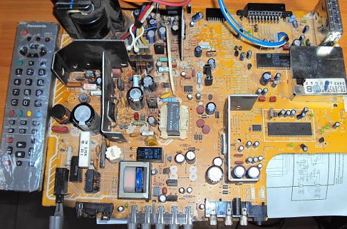

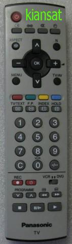

    عکس شاسی و ریموت کنترل تلویزیون PANASONIC TC-28WG12H و مشخصات فنی

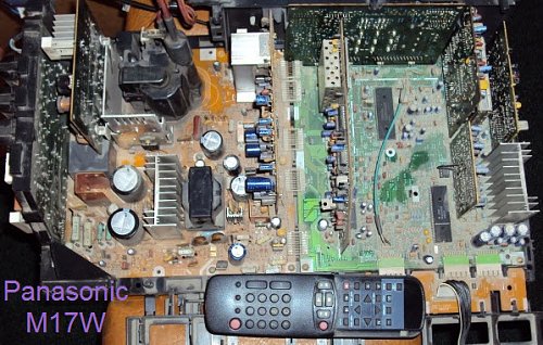

    M17W --------------- chassis (circuit)
    MN1874033T2T - percent.
    24S08 -------------- memory (flash)
    TA8880BN -------- videos
    SAA7282ZP ----- decoder NICAM
    TDA8732 NICAM demodulator ---------
    TA8200AH ------- ULF
    STR M6529 ------ bp
    ENV598c5G3 ---- tuner
    LA7845 ------------ footage
    ZTFG47026A ---- tdks + 2SD2454
    W66LFC995X --- CRT 106 °
    BY -------------------- on trazistorah

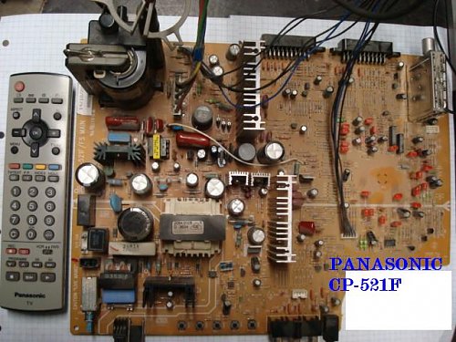

    عکس شاسی و ریموت کنترل تلویزیون PANASONIC CP-521F و مشخصات فنی
    PANASONIC CP-521F
    TDA12021H1/N1/D01 ----------------- UOC
    TDA8358J ---------------------------------- footage
    TDA6107J----------------------------------в/усилители
    STRW6754 --------------------------------- BP
    UV1316/A1-4-----------------------------tyuner
    1302.2001 ---------------------------------- TDKS
    BP Profiles
    DR = 90 volts
    RR = 125volt

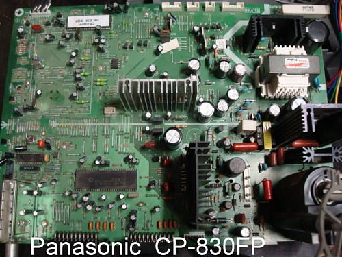

    PANASONIC (DAEWOO) CP-830 Chassis
    SDA555xf version 0.30 --------------m/kontroller
    DDP3315 ------------------------------------ processor scans
    TDA4470 ------------------------------------- p / channel
    MSP3410 ------------------------------------ stereo engines
    TDA8946J ----------------------------------- ULF
    STRF6654 ---------------------------------- BP
    TDA8358J ----------------------------------- footage + EW
    TDA6108JF --------------------------------- in / amp
    1302.2002C --------------------------------- TDKS
    EUR7628030AR --------------------------- RC
    Mode BP DR = 14 volts, RR = 130 volts
    Log in to service mode for PANASONIC
    1 - set the TV up to 99 program
    2 - in the menu image - sharp on the negative
    3 - simultaneously press the remote control - mute button and - the cursor down - on the front of the TV.

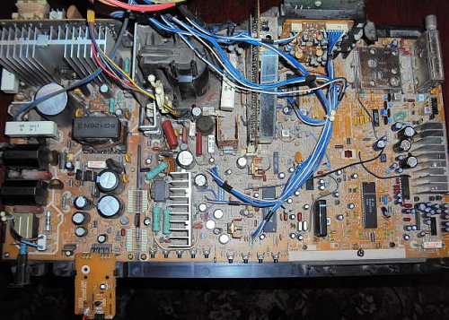

    PANASONIC TX-29V50T -----MX-2A -- chassis
    PANASONIC TX-29V50T
    MX-2A -------------------------------- chassis (circuit)
    MN152810TZN -------------------- percent.
    24C02A ------------------------------ Memory
    AN5607NK -------------------------- in / pct.
    PAL / NTSC
    AN5636K ---------------------------- SEKAM - ► kvaziPAL converter
    AN5179K ---------------------------- upchi
    AN5858K, CD4066BC (2 pcs) - kom.-tori
    AN7169 ------------------------------ ULF
    C1891ACY -------------------------- percent.
    surround sound
    CXA1279AS ------------------------ Reg.
    volume, balance and timbre
    M52317SP -------------------------- converter sound.
    Standards
    TA8859P ----------------------------- corrector raster
    LA7833 ------------------------------- cr
    ENV59898F2 ----------------------- tuner
    STR S6709 -------------------------- UPS
    TLF14470F + 2SD1556 --------- vksr
    M68KTY165X ----------------------- CRT
    Ud in 141.
    D.r in 34.
    In service: click on a service switch S1101 (located next to the switch alignment) TV switches to scan mode appears on the screen SNK. Click S1103 (FUN) to select the necessary adjustments, to exit press S1101
