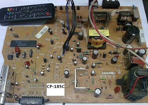

    عکس شاسی و ریموت کنترل تلویزیون DAEWOO CP-185C و مشخصات فنی
    DAEWOO CP-185C
    TDA9381PS/N2/2/0663---------------------UOC
    TDA8357J ---------------------------------------- Frames
    TDA7267 ----------------------------------------- ULF
    TDA6107JF ------------------------------------- Vusilitel
    BSC25-5505 ....... (LTC-505 )-------------- TDKS
    R-40A01 ---------------------------------------- RC
    BP in DR = 135volt RR -= 115

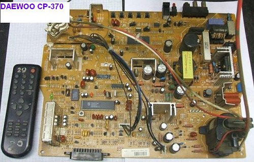

    عکس شاسی و ریموت کنترل تلویزیون DAEWOO CP370 و مشخصات فنی
    DAEWOO CP370
    DW370ASM3 PCA05C57 ------------- Control Processor
    TDA8374A ----------------------------------- Video Processor
    TDA8356 ------------------------------------- footage
    TDA7056 ------------------------------------- ULF
    STRS5707 ----------------------------------- BP
    BSC25-5508 LTC-508 ---------------- TDKS
    DT2-BV12D DOL25S ---------------- tuner
    R-28B03 ------------------------------------ RC

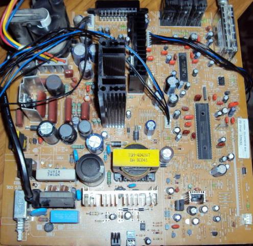

    عکس شاسی DAEWOO DTA-21S7MZF neoSlim ch.CM801S ومشخصات فنی
    DW769670M7-A-B1 ---- percent.
    59M7 8BA02
    ST 24C32wp --------------- memory
    LV1116N -------------------- star. percent. and Reg. sound
    LA42102 -------------------- ULF
    LA7848 ---------------------- footage
    115-B-8A86EU ----------- tuner
    STR-W6754 ---------------- bp
    BSC25 - 0217E ----------- tdks + TT2190
    A51QGT420X -------------- CRT 110 °
    RP at 138. Et al in 98.
    In service: 91, sharpness → min., Close all the menus.
    2 sec. Press: Red, Green, Menu.
    Yield: Menu or St-by.
