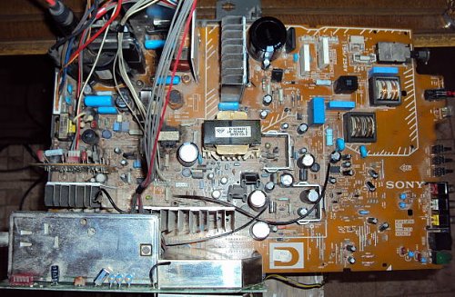

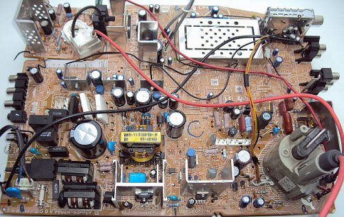

    عکس شاسی و ریموت کنترل تلویزیون Sony KV-BW142M70 ch.BX1S و مشخصات فنی
    TDA11010H / N1B000QL - UOC
    CC8141
    VC96D1
    MO/-/-MU/2.57M
    24WC16w
    1-693-659-11 ----------------- tuner
    STR F6267 -------------------- bp
    8-598-847-00 2SC5885
    AN15524 ----------------------- cr
    AN17804A --------------------- ULF
    A34LRG70X ------------------ CRT
    TDA6108AJF
    Pp 135v. Dr. 43B.
    Log in to the service of stendbaya: DISPLAY, 5, VOL, POWER.

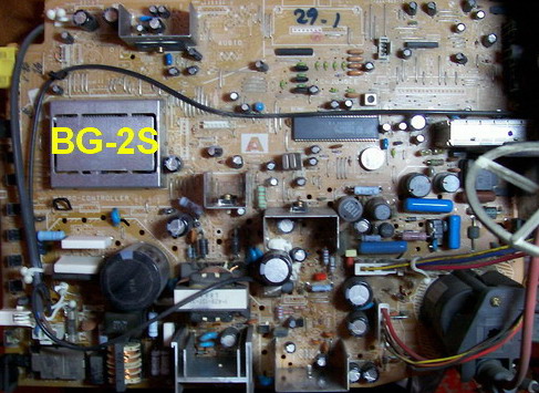

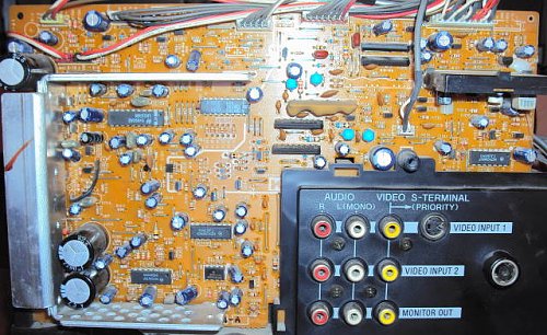

    عکس شاسی و ریموت کنترل تلویزیون SONY KV-G21M2 (Chassis: BG-2S) و مشخصات فنی
    Percent: CXP85220A-058S
    Memory: 24S04
    Remote Control: RM-869
    Video: TDA8375A
    Tuner: BT-AG401
    TDKS: 8-598-811-10 (NX-1746 / / Q)
    NOTES: 2SD1878
    Personnel: LA7830
    ULF: TA8248K
    PSU: STR-S6707 (RR = DR = 115V

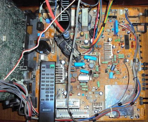

    پیش فرض SONY KV-29C1R---------- BE-3D chassis (circuit)
    SONY KV-29C1R
    BE-3D ------------------------------ chassis (circuit)
    SDA5250M-C6 ------------------ percent.
    CXA2076Q ----------------------- videoprots
    MSP3400-PS-C6 --------------- star. percent.
    ST24E32M6 ---------------------- memory (flash)
    TDA8395T ------------------------ SECAM
    STV9379 -------------------------- footage
    TDA7264 -------------------------- VLF 25 +25 Tues
    TDA2822M ----------------------- VLF Headphone
    8 598 98900 + 2SC4927 ---- vksr
    STR S6708 ---------------------- UPS
    1-693-338-13 -------------------- Tuner
    M68LCT60X --------------------- CRT
    Pp 135 to. Others in 31

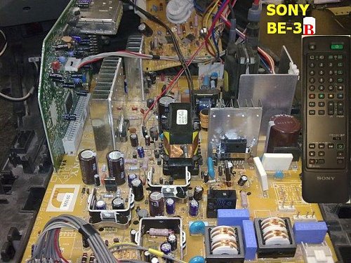

    پیش فرض SONY BE-3B
    SONY BE-3B
    CXP85228 ---------------------------- microcontroller
    TDA8366H ---------------------------v/protsessor
    TDA6622-5X -------------------------стерео
    TDA7264 ----------------------------- ULF
    STV9379 ----------------------------- footage
    STRS6708 --------------------------- B. P.
    CXA1855Q --------------------------- A / V Switch
    143942361 --------------------------- TDKS
    8-598-045-01 ------------------------ tuner

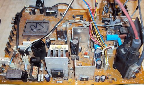

    SONY KV-G21M1 --BG-1S (SCC-J30B-A) - chassis (circuit)
    SONY KV-G21M1
    BG-1S (SCC-J30B-A) ----------- chassis (circuit)
    CXP85116B-651S --------------- percent.
    AT24C04 ---------------------------- memory (flash)
    TDA8366 ---------------------------- in / pct.
    TDA9820 ---------------------------- star. demodulator
    AN5262N ---------------------------- star. regulator
    CXA1315P -------------------------- D / A converter
    LA7016 ------------------------------ Switch
    TA8248K ---------------------------- ULF
    LA7830 ------------------------------ footage
    8-598-323-00 ----------------------- tuner
    8-598-960-10 +2 SD1878 ------- vksr
    STR S6707 ------------------------- UPS
    A51JUH71X ------------------------ CRT
    RM 870 ---------- -------------------- console
    Ud in 115. D.r 115 in.
    Services: Set the TV to standby mode from the console then enter the following commands in Display -> 5 -> Volume + -> Power. 1i4 movement by position, 3i6 increase and decrease values, MUTING write 0 performance record.

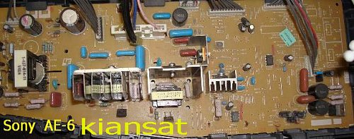

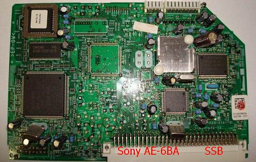

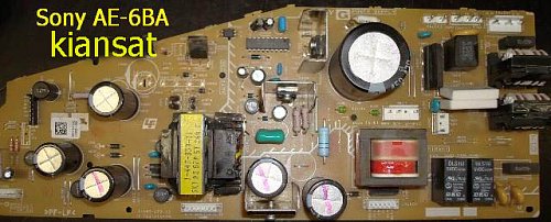

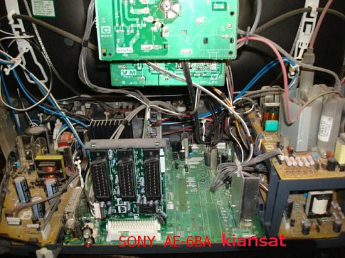

    SONY AE-6BA chassis
    SDA6001 ------------------------------- m / Controller
    DDP 3316C ---------------------------- processor scans
    VSP 9417B ---------------------------- multistandard color decoder scan-rate converter
    STV9379 -------------------------------- footage
    TDA6111 --------------------------------в/усилители (3pc)
    MCZ3001DB 08N50C3 (2) ----- BP
    MCZ3001B 2310DHI (2) -------- CPT
    CXA2149AQ --------------------------- video, audio switch
    8-598-871-11
    (NX-6020 / Z) ---------------------------- TDKS
    Remote RM945
    Log into the service mode:
    On the remote control to click consistently St / by....display (i ).... 5
    prog .... volume .... TV

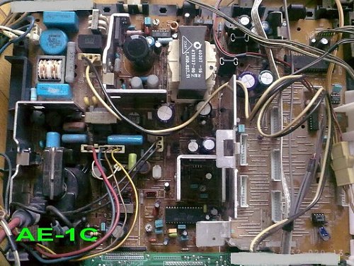

    شاسی : Sony KV-E2921D- AE-1C
    مشخصات مداری
    Main - 1-637-020-13
    Micom - SDA20560-A012
    Memory - SDA2546
    SMPS - TEA2260
    TR Chopper - 40307-16 478037-00 1-450-037-11
    SAW -
    Delay - TDA4660V2
    Video - TDA4580
    Vertical - TDA8170
    Teletext - SAA5246P/E & FCB61C65L-70P
    Sound - TDA2050
    Stereo - TDA6600-2
    Tuner - UV816 KR22
    Tube - A51JXH61X
    FBT - 1-439-493-11
    HOT - 2SD1941
    E/W - TEA2031A
    Deflection - TEA2028B
    RGB Amp. - BF871
