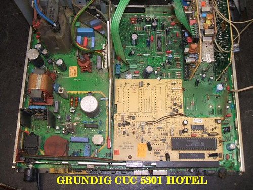

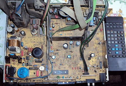

    عکس شاسی و ریموت کنترل تلویزیون GRUNDIG CUC5301 mod P45-540 و مشخصات فنی
    XC411858P ------------------------------ percent control
    SDA2546-5 ------------------------------ mic. Memory
    TDA5931 ------------------------------r/kanal
    TDA3566 ------------------------------ PAL decoder + i / processor
    TDA7245A ------------------------------ ULF
    TDA8214B ------------------------------ footage
    Tuner 29504-101.24 ----------------------------
    M29201-028.01 ------------------------- TDKS
    A41EAM40X01 -------------------------- kinescope
    TDA4605 ----------------------------------- BP
    Dezh.R. = 140V, ud = 125

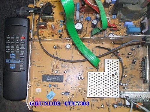

    GRUNDIG CUC7303
    SDA5222-A001 ------------------- percent control
    AT2402 ------------------------------- memory chip
    TDA8361 --------------------------- PAL December in / pct
    TDA7233 ---------------------------- VLF
    TDA3653B -------------------------- footage
    UC3842 ------------------------------ BP
    M29201-031.55 ------------------- TDKS
    (Kinesop 37 cm)
    TP711 -------------------------------- RC

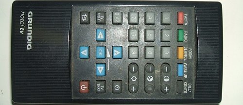

    پیش فرض GRUNDIG T55-449
    GRUNDIG T55-449
    CUC 4401 ------------------------------- chassis (circuit)
    SDA2023 +12 MHz -------------------- percent.
    SDA2526 -------------------------------- memory (flash)
    TDA4481 -------------------------------- mono sound. percent.
    TDA3505 -------------------------------- videoprots.
    TDA4555 -------------------------------- col. percent.
    TDA4650 -------------------------------- col. decoder
    TDA4565 -------------------------------- color corrector. Definition
    TDA4660 -------------------------------- delay
    TDA2579 -------------------------------- page / frame. Synchro / generator
    TDA8140 -------------------------------- driver MUSIC
    TDA8170 -------------------------------- footage
    TDA5931 -------------------------------- IF Video / demodulator
    TDA7245 -------------------------------- ULF
    TDA4605 + BUZ90A ---------------- UPS
    1929 201-028.01 + BU508D ---------- vksr
    Tuner 29504-101.22 --------------------------
    TiP 661 ---------- ------------------------- console

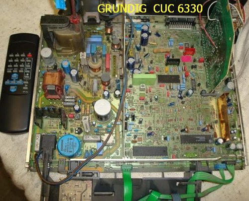

    GRUNDIG chassis CUC 6330 model ST 70-770
    XC411875D ----------------------m/kontroller
    24C04 -----------------------------m/shema memory
    STV2102B -----------------------v/protsessor, PAL decoder
    TDA8174W ---------------------- footage
    TDA7245A x 2 ------------------ ULF
    TDA8145 ------------------------- EW
    TDA4605 + BUZ90 ----------- BP
    TDA6612-2 ---------------------- stereodekoder
    U4460 ---------------------------- UPCHI
    TEA5101A ----------------------v/usiliteli
    M29201-029.51A ------------- TDKS, kinescope A66EAK
    TP711 ---------------------------- RC
    BP .... Ud = 140V, DR = 160
    Log-in service: Hold the button (I) on the remote control switch on the TV the power button.
    The entrance to the channel tuning (manual): press P / C, and then click OK. If you hold down the P / C more than 5 seconds - to include ATS-automatic configuration, confirmation - OK button
    Contrast Adjustment - button (I) and then OK
    Balance adjustment, high-low frequency - the button (I) then the MUTE (Speaker

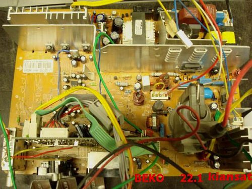

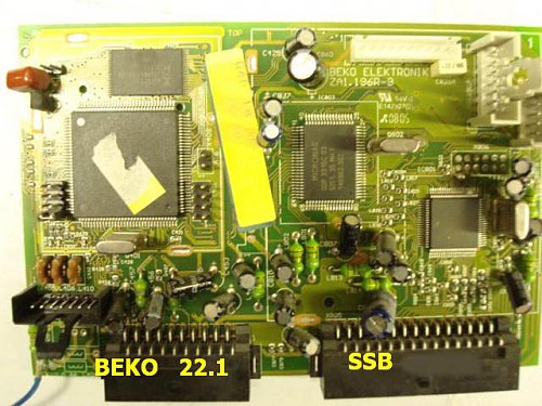

    GRUNDIG mod MF72-2510/8TOP he is - BEKO chassis 22.1
    SDA6000 -------------------------m/kontroller
    24C32 ----------------------------- m / memory circuit
    DDP3315C ----------------------- processor scans
    VSP9405B ----------------------- in / Processor
    29LV160BE1 -------------------- flash
    MSP3410G ---------------------- stereo processor
    TDA7297 ------------------------- ULF
    TDA6111Q -----------------------v/usiletel (3 pieces)
    STV9379F ----------------------- footage
    TDA16846 ----------------------- BP
    003321185 (HR6729) -------- TDKS
    A68EPDXXXX ------------------ kinescope
    Modes of BP ... DR = 145 volts, RR = 138 volts
    Log-in service:
    BEKO - MENU on the remote and code 9301
    GRUNDIG - MENU on the remote and code 8500

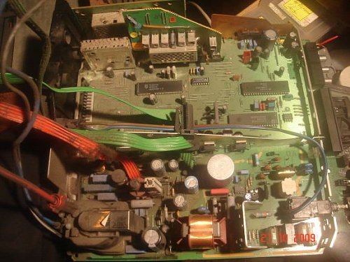

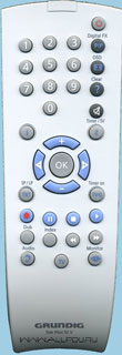

    GRUNDIG ST55-750/9TEXT CUC7350
    CUC7350
    xc411867p --------------------m/kontroller
    c7350mlt/pal01
    24s04 ------------------------ m / memory circuit
    tda9811 -------------------- star. demodulator
    24c02 ------------------------ m / memory circuit
    msp3410 ---------------- stereo engines
    g042329/005
