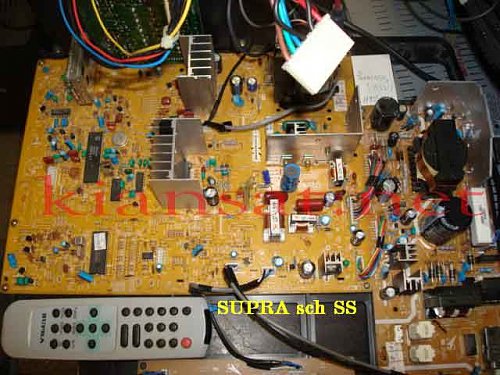

    SUPRA chassis SS aka Onyx chassis CH-10D
    S3P8849XZ ---------------------- Control Processor
    AT24C08 -------------------------- mikrsh. Memory
    TDA8844 --------------------------v/protsessor
    TDA8350Q ----------------------- footage EW
    TDA7057AQ --------------------- ULF
    STRF6656 ------------------------ BP
    BSC68H -------------------------- TDKS
    PD DR ... = 85B, RR = 135 for 25-29 inch CRT
    Log in Serviss:
    1 - With the remote control to set the volume - at least.
    2 - Press the MUTE (RC) without releasing the button - Press the MENU button on the control panel until the raster letters S.3 - Press CAL on the remote control - will open the first window menyu.Perehody of "boxes" as a pressing CAL. Exit - Button St / by
