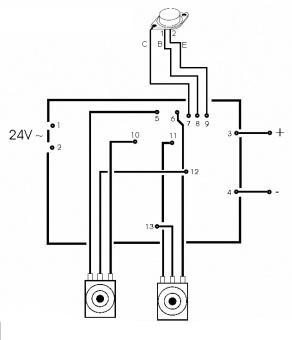

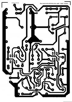

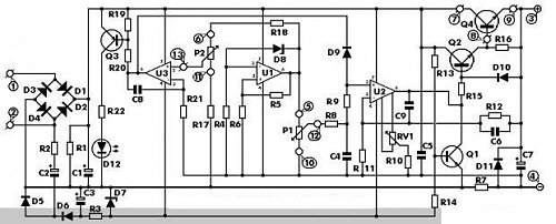

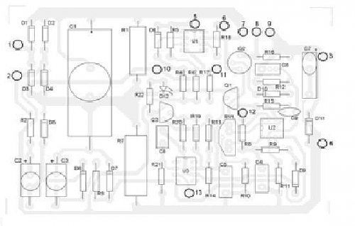

    منبع تغذيه صفر الي 30 ولتي به همراه مدار چاپي و ساير مشخصات كامل (يك مدار مشهور و صد در صد عملي ) تست شده است.
    نقشه مدار :
    نقشه مدار چاپي :
    و راهنماي جايگذاري قطعات و سيم بندي ان :
    ليست قطعات مصرفي :
    R1 = 2,2 KOhm 1W
    R2 = 82 Ohm 1/4W
    R3 = 220 Ohm 1/4W
    R4 = 4,7 KOhm 1/4W
    R5, R6, R13, R20, R21 = 10 KOhm 1/4W
    R7 = 0,47 Ohm 5W
    R8, R11 = 27 KOhm 1/4W
    R9, R19 = 2,2 KOhm 1/4W
    R10 = 270 KOhm 1/4W
    R12, R18 = 56KOhm 1/4W
    R14 = 1,5 KOhm 1/4W
    R15, R16 = 1 KOhm 1/4W
    R17 = 33 Ohm 1/4W
    R22 = 3,9 KOhm 1/4W
    RV1 = 100K trimmer
    P1, P2 = 10KOhm linear pontesiometer
    C1 = 3300 uF/50V electrolytic
    C2, C3 = 47uF/50V electrolytic
    C4 = 100nF polyester
    C5 = 200nF polyester
    C6 = 100pF ceramic
    C7 = 10uF/50V electrolytic
    C8 = 330pF ceramic
    C9 = 100pF ceramic
    D1, D2, D3, D4 = 1N5402,3,4 diode 2A - RAX GI837U
    D5, D6 = 1N4148
    D7, D8 = 5,6V Zener
    D9, D10 = 1N4148
    D11 = 1N4001 diode 1A
    Q1 = BC548, NPN transistor or BC547
    Q2 = 2N2219 NPN transistor
    Q3 = BC557, PNP transistor or BC327
    Q4 = 2N3055 NPN power transistor
    U1, U2, U3 = TL081, operational amplifier
    D12 = LED diode
