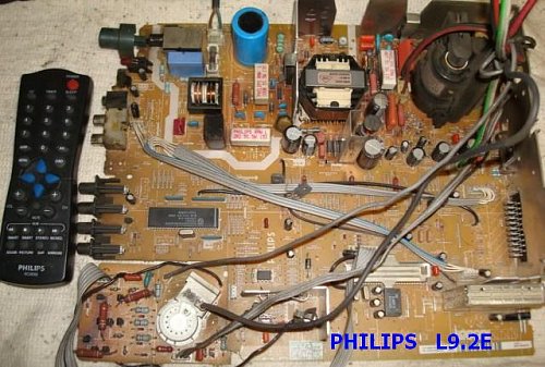

موضوع: شاسی تلوزیون PHILIPS L9.2E و مشخصات فنی مداری
    PHILIPS L9.2E
    SAA5542PS/M4/0270 ------------m/kontroller
    TDA8842 ------------------------------В/процессор
    TDA7056B --------------------------- ULF
    TDA9302H --------------------------- Frames
    MC44603AP ------------------------ B. P
    1142.5093D ------------------------- TDKS
    UV1316/A1-2 ----------------------- Tuner
    Servis: 0-6-2-5-9-6 dial code and click the button Mute - fall into the mode SAM.Dlya transition mode SDM to "muzzle" you press the Vol-button and the P-
    BS .... Ud = DR = 95 volts
