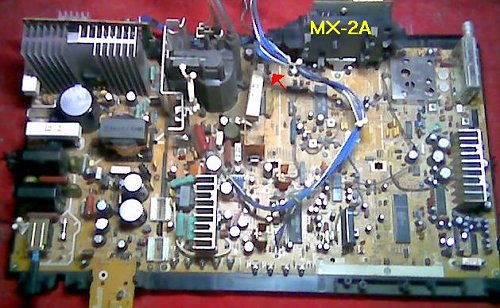

    Panasonic TC-25V50R chassis MX-2A
    Pct ----------- MN152810TZN
    Videoprots --- AN5607NK
    SECAM --------- AN5636K
    Switchboard - AN5858K
    Memory ------- 24C02A
    PWM ---------- STR-S6709
    Personnel -------- LA7833
    Sound ----------- AN7169
    TDKS --------- TLF14470F
    Tuner -------- ENV59896F2
    Log-in service: click on the chassis S1101 SERVICE SW (in the photo marked with a red arrow).
