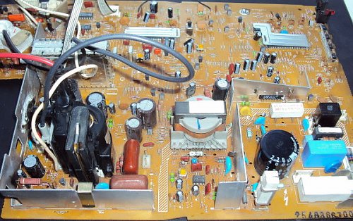

    PHILIPS 20GX8552/59R
    ANUBIS S DD ------------------------------- chassis (manual)
    PCA84C844P/200 ------------------------- percent.
    ST 24C04 ------------------------------------ memory (flash)
    TDA8362E + TDA8395P + TDA4665
    TDA3653B ----------------------------------- footage
    TDA7056A ----------------------------------- ULF
    TDA4605-3 + P6N60FT ------------------ UPS
    UV913/IEC ----------------------------------- tuner
    1142.5020 + BU1508DX ----------------- vksr

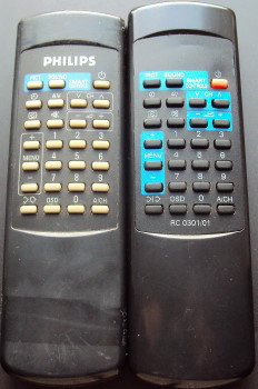

    RC0301/01 ----------------------------------- Console (native - on the left)
    510UFB22-TC63 --------------------------- CRT
    Pp 95 in.
    Log-in service: short-circuit 1pin EEPROM (kontr. point M31) to housing (for a short time until it turns on). Exit - Stby
