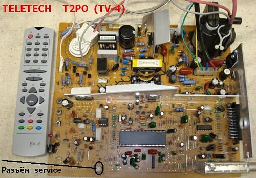

    TDA9351PS/N3/2/1933
    TAURAS _004 NXP B.V. 2003 --------------------- UOC
    24CO8 ------------------------------------------------- ------- m / memory circuit
    TDA7056B ------------------------------------------------- - VLF
    UC3842 + 5N60C ---------------------------------------- BP
    STV9302B ------------------------------------------------- - footage
    JF0501-32815 --------------------------------------------- TDKS for 37cm CRT
    Bp-6 ----------------------------------------------- ------------ RC not the original, but is suitable for 100%
    BP Profiles RR = DR = 115 volts
    The unit starts with a "clean" memory chip.
    Log in MENU - click and hold the Menu button on PDU.Dostup to operational settings - short press on the remote Menu, or via the colored buttons.
    Log in to the service: On the TV close pins service - Information on foto.Vyhod - the TV button on the remote control
