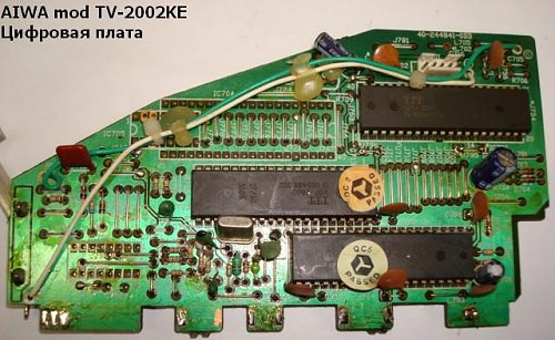

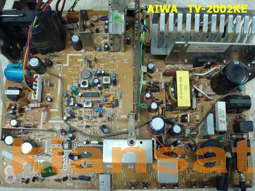

    AIWA TV-2002KE
    TVPO-2066 D05/04 --------------------m/kontroller
    LA7550 -------------------------------------r/kanal
    STRS6307 -------------------------------- BP
    TDA1013B -------------------------------- ULF
    VSP2860 ----
    VCU2133 ----
    SPU2243 ---------------------------------- Chips digital board
    FCM2012E21A ------------------------- TDKS for CRT 51 cm
    Mode BP for + B: DR = 17 volts, RR = 112 volts
    Log-in service: click on the S006 board TV (stands apart from others) and the Display button nak RC. Remembering button (- -) on the remote control
