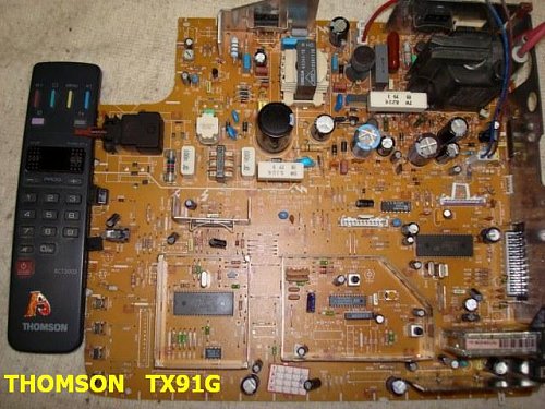

موضوع: شاسی تلوزیون THOMSON TX91G chassis همراه با مشخصات فنی مداری
    ST9293J9B1/JAB ----------------m/kontroller
    24C04 ------------------------------m/shema memory
    STV8224A2 -----------------------r/kanal
    STV2118 --------------------------v/protsessor, PAL
    TDA1771 -------------------------- footage
    TDA7253 -------------------------- ULF
    40331-01 -------------------------- TDKS, CRT 37 cm
    BP diskretnyy.Rezhimy the chain + B ----- DR = 125 volts, RR = 110 volts
    The unit starts with a "clean" memory chip
    Log into the service mode:
    1-move TV Dezh.R.
    2 - turn off the TV button "network"
    3-hold down the button on the remote VT (blue) - switch on the TV network button.
    4 when a screen - to let go and then briefly press the VT
    Listen
    Read phonetically
