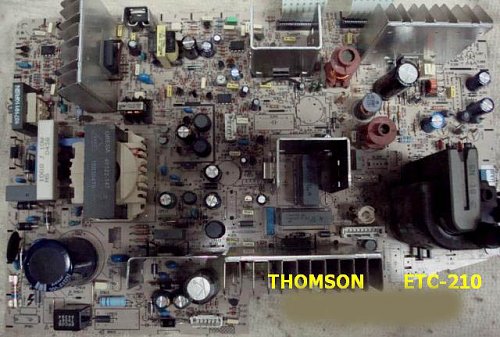

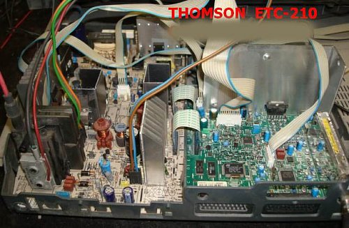

    شاسی تلوزیون THOMSON ETC-210 chassis

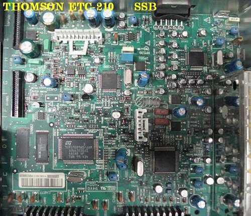

    ST92RL49B9QO ------------------ m / Controller
    24C16W6 --------------------------- m / memory circuit
    VSP9402A -------------------------- in / Processor
    TDA9330H ------------------------- RGB-processor
    MSP3411G ------------------------ Stereo Processor
    TDA7296 --------------------------- ULF
    TDA6108JF ----------------------- in / Amplifiers
    FE6230B --------------------------- tuner
    TDA8177F ------------------------- footage
    40351A - 5 ------------------------- TDKS, kinescope A68QCP993X50
    Viper20 + P17N80C ------------ BP

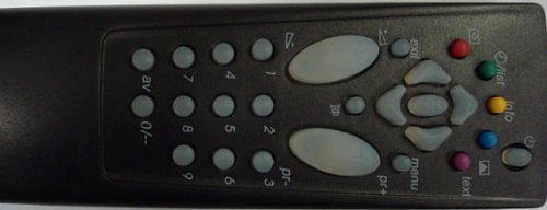

    RCT-100 ---------------------------- RC
    Mode BP the chain + B: RR = 138 volts, DR = 0 - the main B.P.otklyuchen works BP Standby
    Log into the service mode:
    1 - translate TV in the DR with remote control.
    2 - turn off the TV button "network"
    3 - hold down the button (P -) and (Vol -) in front of the TV - turn the unit on the power button.
    Keep these buttons - more than 5 seconds
