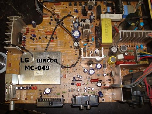

    VCT-49 [YF/P7/C7 ---------------m/kontroller
    24C16W6 ---------------------------m/shemy memory
    STRX -6756 ------------------------ B. P.
    TDA4863AJ ------------------------ footage
    LA42152 ---------------------------- ULF
    TDA6109JF ------------------------v/usiliteli
    6174V - 5013 ---------------------- TDKS, kinescope A68Q xxx

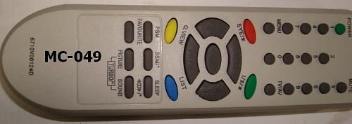

    Log into the service mode:
    On the remote control and front panel, simultaneously press and hold it for about 10 seconds, the MENU
    Go to "windows" service mode using the colored buttons.
