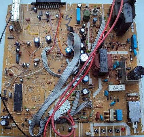

موضوع: CA-1 --- chassis (circuit)SHARP 54DM-12SC
    SHARP 54DM-12SC
    CA-1 --------------------------------------- chassis (circuit)
    SDA5222-2 B001 --------------------- percent.
    24C04 ------------------------------------ memory (flash)
    TDA8842H ------------------------------ in / pct.
    BC328, BC338 ------------------------ VLF
    BD825, BD830 ------------------------ footage
    UV1315 / S ------------------------------- tuner
    P4NB80FP ----------------------------- key IP passthrough. UPS
    OREGA 40332-32 + BU508DFI - vksr (without TMSa)

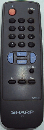

    G1059SA -------------------------------- console
    A51EFS83X391 (tnomson) --------- CRT
    Ud in 110. D.r in 96.
    Log-in service: clamp on lokalke CH + VOL-and turn the power button.
    Yield: Menu.
