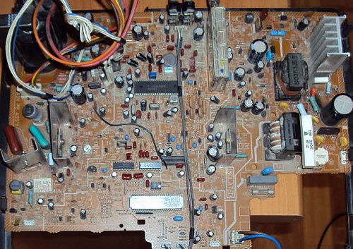

موضوع: شاسی تلوزیون جی وی سی JVC AV-G21TB-2 ch.CA (1004A)
    M37212M4-052SP ------------- percent.
    24C04 --------------------------- memory (flash)
    CEEU534-B04 ------------------- tuner
    M52343SP, M52325AP, U3660
    AN5265 ----------------------------- ULF
    LA7837
    CJ28267-00AJ1 +2 SD1878
    STR S6707

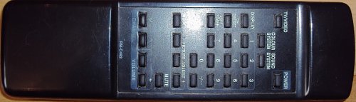

    RM-C462 ------------------------- console (pictured second language)
    A51KQQ20X --------------------- CRT
    Ud in 115. D.r in 95.
    Simultaneously press the remote control: Display and Picture Mode.
    Second press - Login System Constant.
    To exit the service menu - return to the Service,
    then click Mute
