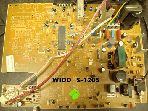

    VIDO mod. 54CTV4085
    He - POLAR
    S-07 chassis
    TDA9381PS/N3/1/1744
    (POLAR 4.2) ---------------------- UOC
    24C08WP ---------------------------- m / memory circuit
    TDA7056B --------------------------- ULF
    STV9302A --------------------------- footage
    UC3844B + P4NK80 ------------- BP
    PET19-37M -------------------------- TDKS, kinescope 54 cm flat
    TAF5-E2123 ------------------------- Tuner

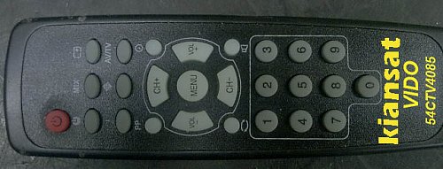

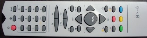

    Bp-6 ------------------------------------ RC, not the original, but fits up to 99%
    Below - the original remote control for VIDO
    BP Profiles DR = 148 volts, RR = 125 volts
