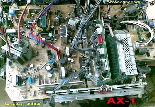

    SONY TV SCHEMATIC
    MODEL : KV-HR29M91 - KV-HR34M91
    Chassis : AX-1
    Master Micro - CXP961048-013Q
    PF Micro - M306VSMG-555FP
    Memory - 24C32-WMV6T
    FLASH ROM - MBM29LV160BE-90TN-AX005
    SDRAM - MY57V281620HCT-H-TR
    Reset - MM1482BFBE
    SMPS - MCZ3001DB
    135v CONT - BA9759F-E2
    Vertical - STV9379
    Component I/F - CXA2170Q
    Memori Stick Interface - MB93491
    Audio Processor - NJN1148
    Sound - TDA7296, TDA7490L
    Tuner - BTF-WG442
    Tuner PIP - BTF-LG434
    D/A Converter - SAA5360HL/0004
    Main Combfilter - SXA2163AQ
    Input Select - CXA2188Q, CXA2189AQ
    CCP2 - CXD3802BQ
    SDRAM - MT48LC2M32B2TG, MSM56V16160F-8T
    DRC-M - CXD2097BQ
    MID-X - CXD9509AQ
    FBT - NX-6020/M3B4
    HOT - 2Sc5778-RB
    S-COR-OUT - 2SK3262
    RGB Amp - TDA6120Q

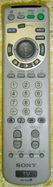

    remote: - RM-1008
