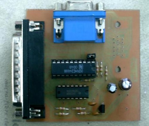

    1) Using D/L Jig

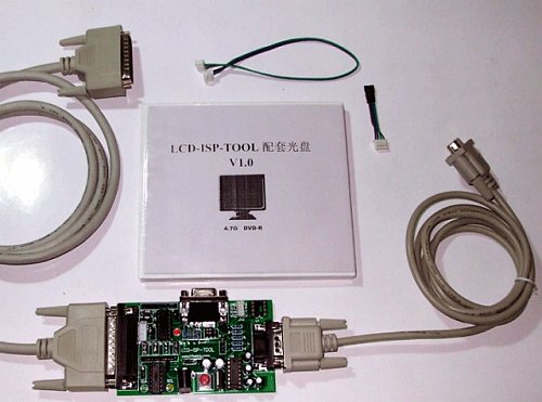

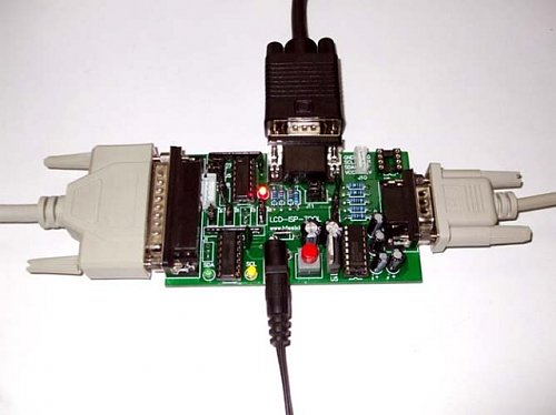

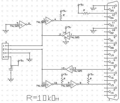

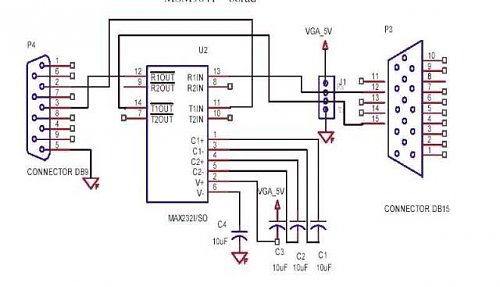

    4.1.1. Using D/L Jig

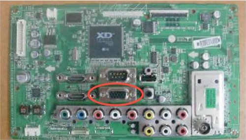

    (1) Preliminary steps

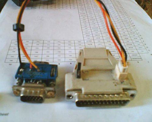

    1) Connect the download jig to D-sub(RGB) jack
    (2) Download steps

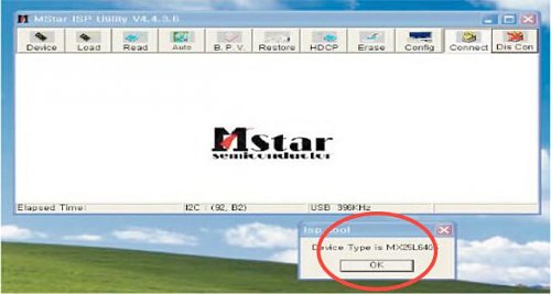

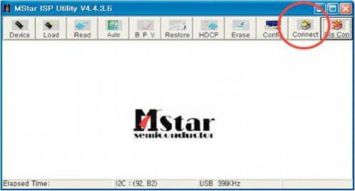

    1) Execute ‘ISP Tool’ program, the main window(Mstar ISP
    utility Vx.x.x) will be opened
    2) Click the “Connect” button and confirm “Dialog Box”

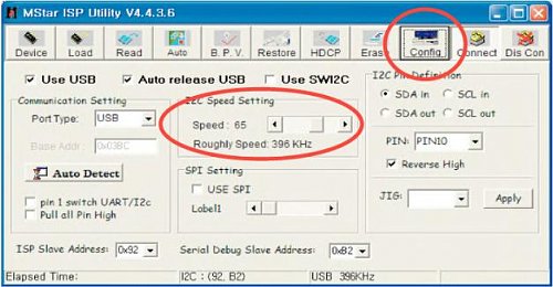

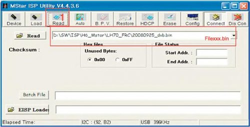

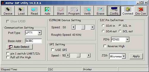

    3) Click the “Config.” button and Change speed I2C Speed
    setting : 350Khz~400Khz
    4) Read and write bin file.
    Click “(1)Read” tab, and then load download
    file(***X.bin) by clicking “Read”.

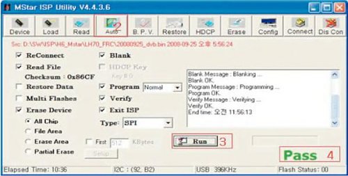

    5) Click “(2)Auto” tab and set as below
    6) Click “(3)Run”.
    7) After downloading, you can see the “(4)Pass” message.

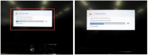

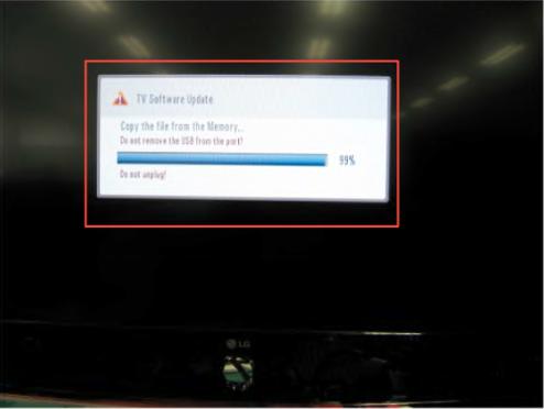

    4.1.2. Using the Memory Stick
    * USB download : Service Mode
    1) Insert the USB memory stick to the ISB port.
    2) Automatically detect the SW Version.
    -> S/W download process is executed automatically.
    3) Show the message “Copy the file from the Memory”
    4) After Finished the Download, Automatically DC Off -> On

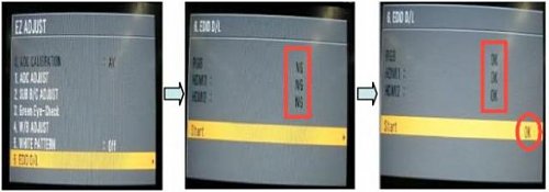

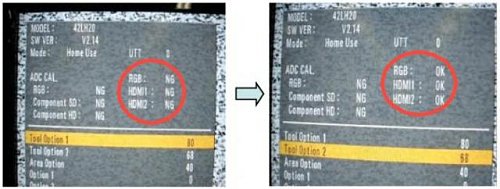

    4.4. EDID D/L method
    Recommend that don’t connect HDMI and RGB(D-SUB) cable
    when downloading the EDID.
    If not possible, recommend that connect the MSPG equipment.
    There are two methods of downloading the edid data
    4.4.1. 1st Method
    EDID datas are automatically downloaded when adjusting the
    Tool Option2.
    Automatically downloaded when pushing the enter key after
    adjusting the tool option2.
    It takes about 2seconds.
    4.4.2. 2nd Method
    * Caution :
    Must be checked that the tool option is right or not.
    If tool option is wrong, hdmi edid data could not be
    downloaded well.
    1) Press the ADJ key
    2) Move to the EDID D/L and Press the right direction key(G)
    3) Press the right direction key(G) at Start.
    4) After about a few seconds, appear “OK”, then compele.
    Caution
    Don’t connect HDMI and RGB(D-SUB) cable when
    If the cables are connected, Downloading of edid could be
    failed.
