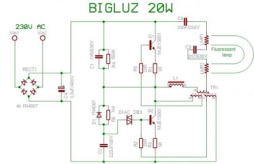

    Bigluz 20W
    Compact fluorescent lamp Bigluz 20W use classic wiring with a small changes. Values of parts are modified for bigger power.
    Photo of opened lamp Bigluz 20W.

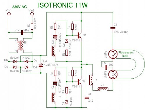

    Isotronic 11W
    Lamp Isotronic 11W use a little modified wiring, where doesn't exists starting circuit with a diac. Lamp starts probably thanks to capacitor C1.

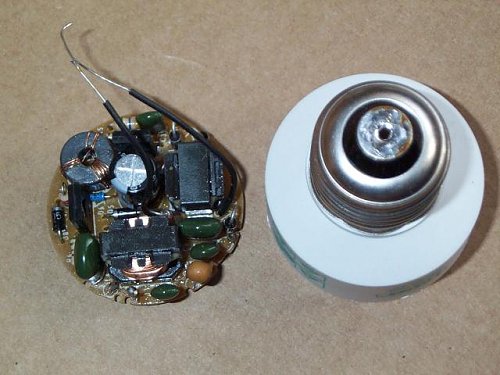

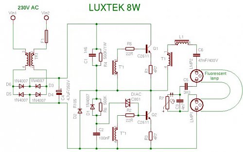

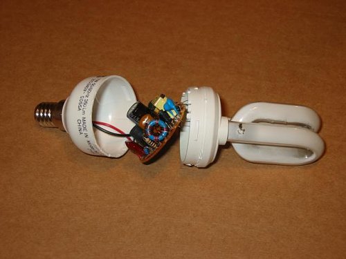

    Luxtek 8W
    Lamp Luxtek 8W use classic wiring with a small changes. Interesting is only thermistor, which probably makes light start and filament preheating.
    Photo of board with a electronics and upper side of cover.

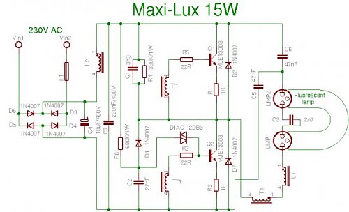

    Maxilux 15W
    Lamp Maxilux 15W use classic wiring.

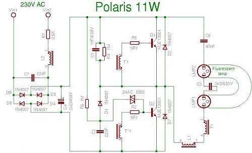

    Icon16 پاسخ : نقشه لامپ كم كم مصرف Bigluz 20W
    Polaris 11W
    Lamp Polaris 11W has a small thread and changes some values of components. Wiring is classic.

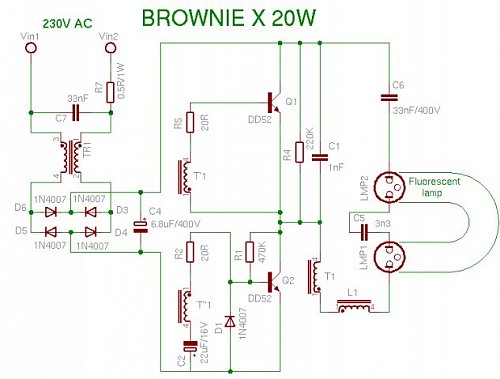

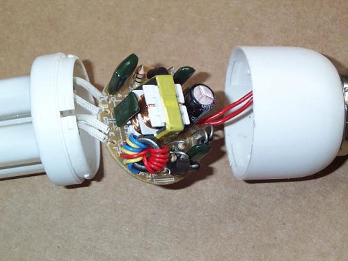

    BrownieX 20W
    BrownieX 20W lamp has a simplified wiring like a Isotronic lamp.

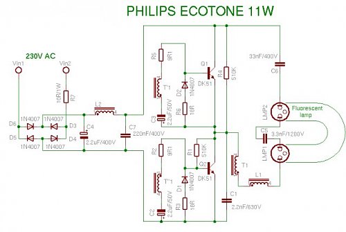

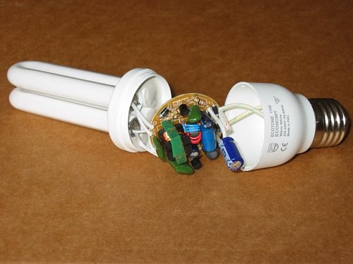

    PHILIPS ECOTONE 11W
    Lamp PHILIPS ECOTONE 11W use again simplified wiring like a Isotronic lamp. This lamp compared to other has a right dimensed components, that electronics probably can live longer. Wiring is less cheated than others. It has coil L2 for blocking HF interference and capacitor C1 for voltage 1200V, which is very much stressed. Tube is superior compared to a no-name types. Light color "warm white" brings light of classic bulb and doesn't have a small pink tone like others. Tube is a little longer and have much light compared to others 11W types. All these lamps, which I have from several series have identical color tone and brilliance. Compared to lamps MAWAY, where every item have different color tone, some have destroyed electronics, some have pipe with a lost vacuum etc... It is seen, that lamps from marked manufacturers have guaranteed parameters and better quality than no-name.
    Photography of opened Philips lamp.

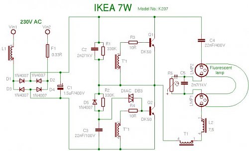

    IKEA 7W
    Lamp IKEA 7W has classic wiring like a Luxar 11W. Component values are modified to a lower power. Parts are enough voltage dimensed. Failure was overburned one of filaments. Lamp was on continuous for one year, which is over 8500 hours. Life time corresponds to a label specifications.
    Photography of opened lamp IKEA 7W

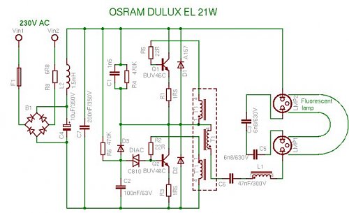

    OSRAM DULUX EL 21W
    Lamp OSRAM DULUX EL 21W has a classic wiring diagram. In contrast to a previous OSRAM lamp doesn't have thermistor for slow start. She has overburned one filament.
