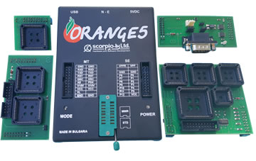

    orange 5
    تصاویر کوچک فایل پیوست تصاویر کوچک فایل پیوست fcba3254eb8d2ef44e24bec95f78b25c.jpg

    سلام من تونستم این مشخصات رو واسش پیدا کنم
    Original Orange5 Professional Programming Device
    Orange5 Technical Info:
    - USB power supply (USB2.0/3.0)
    - Universal easy to plug panel ZIF16 for EEPROM
    - Control of contacts in the sockets
    - Two expansions compatible with Orange4 and Omega MTRK
    - Protection against overcurrent
    - Overload voltage protection
    - Two types of power supply: Standart (USB) and enhanced (USB + external power supply)
    - Three 3 adjustable voltage and current control: Voltage of power supply ( 2.0...5.0V ), programming voltage (2.0...21.0V), additional static 10V for microcontrollers
    - High-speed bidirectional pin drivers with adjustable voltage (2.0...5.0V)
    - Wave cycle generator with frequency ( up to 24 Mhz) and out voltage(2.0...5.0V) adjustment
    - Capability of functional emulation of class CDC USB devices
    - Built-in 32-bit virtual machine
    - Supported interface: I2C, SPI, MicroWire, JTAG, UART, BDM, ISO7816, K-LINE (via adapter), CAN (via adapter)
    - Programmer is encolsed in a functional box. Supported working under Windows XP/7 32bit. [*Win8.1]
    * Installation and Work with Orange-5 under Windwos 7 and Windows 8.1
    Orange 5 is a professional programming device for memory and microcontrollers. Unique feature of the current series programmers is built-in macro language for writing down protocols, which gives fast and easy capability to add new types of micro schemes, precisely meeting manufacturers' requirements to read/write algorithms.
    اینم لیست انواع آدابتور واسه این مدل :
    Packing List:
    1. Orange-5 (include 05BP2&HC11A/Exx; TMS; K/CAN)
    2. SOIC8 14 93Cxx adapter
    3. SSOP8/DIP8
    4. Adapter 908AS60/AZ60 QFP64
    5. Adapter 68HC(7)05P3/E6
    6. Adapter 05B/X 705B/X QFP64 V2
    7. Adapter 11PA8/11E9 QFP64
    8. Adapter 68HC05H12
    9. Adapter 68HC11EA9
    10. Adapter 908AS60
    11. Adapter 9S12Dxx
    12. Adapter 912Dxx
    13. Adapter 9S12X
    14. Adapter 912B32 QFP80
    15. Adapter 68HC11F1
    16. Adapter 68HC11KA4
    17. Adapter 68HC11L6
    18. Lead 05B6 WDT VW immo incircuit
    19. Lead for EWS3 mask 0D46J
    20. Lead 912 (9S12) incircuit
    21. Lead 908 (08) incircuit
    22. Lead 705E6 incircuit
    23. Adapter TMS374C003A
    24. Special Software ImmoHPX
    واینم ادرس وب سایت
    http://www.alibaba.com/product-detail/Original-Orange5-Professional-Memory-Microcontrollers-Programming_60362780655.html?spm=a2700.7724857.29. 117.SyL5ib
